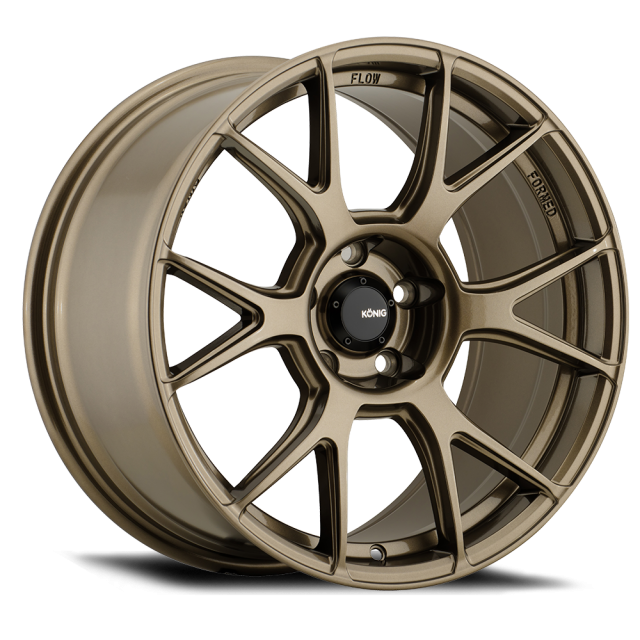

Hello all! I've got an emergency situation and Konig isn't getting back to me. I put 19x10.5B 23mm offset on the rear and the tires poke way too much. Does anyone know for sure if the 19x9.5A 35mm offset clear the Brembos? I know the A profile is whats for a square or front setup, but the video by Konig explaining A vs B says not all will work. Confusing at best. Any and all help would be greatly appreciated! Thanks!
Not sure what the "A" means but I have 19x8.5 35 on the front of my car, no issues. Your offset in the rear with the 19x10.5 should be 45 offset.

I was using one of those calculators for offset online and thought that it would only poke out a little bit, but no! It was about an inch. Way too much for me. Had to go with a 19x9.5A 35mm. The A/B profile is all about the calipers. I guess the B profile is more concave and they recommend using the A profile if you're running a square setup. So I'm taking the chance that the 9.5A 35mm will work. Bums me out that Konig doesn't make a 10 or 11 in the proper offset in the gloss bronze.

You should be good in the front but the rear should have been 19x10.5 45 to be able too keep the wheel tucked inside the fender. Since your in AZ you should have went to Element wheel in Chandler an talked to Taylor about wheel sizes & offsets. They cut my wheels for my car, they're very good at what they do.
