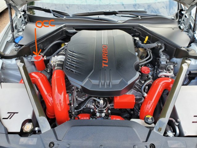

PS when you get your car, If I were you, pick up a Oil Catch Can for the PCV side of the engine. They are a must for GDI turbo engines, here's a picture pointing at it..

Thanks Spider, that was on my list given what I've read. I'll have to wait for exhaust so maybe I'll do similar to you and run JB4 for a year or so first. Can't wait, hopefully get it next week.
