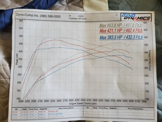

I finally got my car on the Dyno, I went to Dyno-Comp in Scottsdale Arizona. The stock tune was with my bolt on mods with a stock ECU tune so with Mid pipes, Catback, JT CAI & JT FMIC, no JB4. I posted these results on social media an there was some backlash from some people, telling me there's no way you got those numbers on a stock tune or they said protuner is get 30+ more HP then that. Tried to explain to them that I'm NOT running WMI or E85, If I run those two mods then I would be over 500whp no problem. I was a little disappointed on the JB4, It only gave me 38hp gain. They did tell me if I ran better gas I will get more power & I can run 1 to 2 gallons of 100 octane race gas my power will jump up. Over all I'm very happy with the results, It's like a different car. Driving in comfort mode now was like driving in sport mode with the JB4 installed..
That dyno run was not the final tune, The car was getting a little over boost on the top end because it's running at 19psi but all good with the final tune..

Thanks, It's not really a flash that I got, Dyno-Comp goes into the ecu an enhances the settings so if I go to the dealership an they hook up the computer to it they won't know it's their. The only way they would know if the car was tuned is if they drove it an felt the power. The HP & Torque numbers I got are a little conservative, They have their dyno so it reads 10% lower then what the car is actually putting to the ground so if I went to a Dynojet it would read higher. They had a guy run his car at Dyno-Comp an put down 517whp then he took it to Dynojet the same day an did a run, putting down 567whp.
